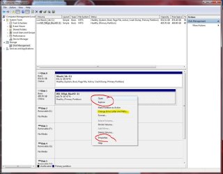

So you are saying Open & Explore are grayed out ?

I've attached a screen shot of the disk management screen. When right clicking the open option isnt even visible.

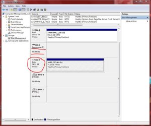

Your snip looks like the disk has not been initialized or that it is showing as a USB removable card / flash slot ? Here is a snip of my 80gb JAK Ext HD :confused: It also shows one of my USB card reader drives as empty (which it is a the moment) .
