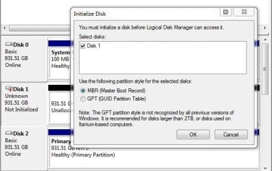

I open disk management with either one of them plugged in, i can hear the disk is running and all, I see Disk1 appear on my disk manager screen... it says unknown and not initialized right on the left on the virtual disk manager
and when I open this screen, it prompts me to initialize the disk
It says:
"You must initialize a disk before Logical Disk Manager can access it."
I mark Disk1 and select Master Boot Record as partition style, and when I click OK, there's an error message saying "the device is not ready"
it worked before, it is actually brand-new.

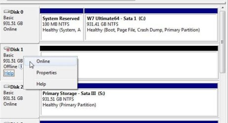

I'm sorry... when I right click on it the only options I get are Offline, which tells me the same "the device is not ready" msg, properties and uninstall.
I believe it is already online, so where can i open the New Drive Wizard?

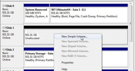

When you right click on the center portion to the right the new volume wizard as it is called will appear. The screens here will show how that looks since one should be familiar already. These were from a guide I made up while the last shows how to mark a volume as active in case that is needed there as well.

yeah the problem is that it doesn't initialize, it tells me device isn't ready and stays as is. i simply cant open the drive in My Computer, or format it from the disk manager screen, cause it stays as unknown and not initialized :S
windows 7 64bit
windows 7 64bit
The two things at the Seagate support site to look over are for new installation and previously working which seems to apply.
For new installation, External Hard Drive Troubleshooter for Windows 7 and Vista
For previously working, External Hard Drive Troubleshooter for Windows 7 and Vista
Those are for checking the drive's status in the Device Manager since you haven't been able to get anywhere in the DM as far as initializing the drive. If it was just bought and found defective I would simply say return for exchange or refund. But these will cover how it is seen in the device manager.

thank you for that, i followed instructions i now have my disk online in the disk management screen... now what do i have to do to be able to store data on it... (It still doesn't appear on My Computer as a drive)

Once it was seen online you simply go back into the Disk Management tool there to right click on the volume in order to select a drive letter. You may possibly see the new volume wizard come up. That be seen mainly for "raw" unpartitioned drives but Windows prompt you on formatting it if you skip past that.
Once a drive letter is set and you see a auto play popup showing it being searched by Windows with the option to view files you can look in Computer or Windows Explorer to see it present. The drive will have been initialized during right click to change drive letter or new volume wizard if seen.
You wouldn't need it turned into a dynamic volume since you are not running a server OS there. Most desktops and laptops alike 99% simply see a basic volume to begin with. The wizard will be mbr by default where you would simply go onto the next screen. Since this is an external not internal being used for storage and not seeing an OS you would only need to see the few basic steps there.
You'll be surprized how fast and easy it actually is once you have it set.
