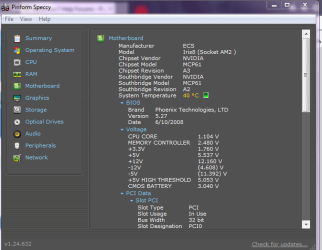

Am fixing a friends older Compaq some idea of the specs in the Speccy snip/s.
Problem is the CPU is running rather hot average 35C at idle and up to 60C on scans and net searches.
I have cleaned everything redone the compound with Arctic Silver and reseated all the plugs etc etc
Now the problem is the case and CPU fans are not running fast enough - the volts at the 24 pin are fine - jut on 5.06v each red. Now the volts at the fan headers both the CPU and back case fan are 4.6v and I know they can run faster because I have had them out and un on my test PSU.
So any idea on why the volts are dropping from the 24 pin to the headers??
CPU fan runs full blast on power up then slows to a steady - what I can only describe as what one would exect on idle.
Temps can be seen in the pics and the discrepsancy or so it seems with the volts whetaer tis is Specy or the machine I don't know.

Maybe power supply problem. Many factory PC's have marginal power supplies and over time they can deteriorated and unable to handle the power load. One area to look at. If you have another power supply you can use in the PC, for testing, that would be one thing to try.

Thanks Jack I didn't get a mail to let me know you had replied mate.
The PSU checked out fine although the watts are a bit on the pathetic side at 228.
Still since then I have installed the rear fan to a Molex connector and it is running as fast as it should and dragging a little more air albeit it hot through the case which is sadly lacking in a lot of inlet venting.
I also installed CPUID HWMonitor and the temps now are as in the pic the only thing is the two cores are quite different temps I expected some but 10C has got me wondering if the CPU is on the way out?
The machine is a tiny bit noisier but as long as the temps are down eh?
I think Speccy could do with bit of work on it to be honest as it is still showing 35C!

From the Speccy picture in post #1 your 3.3V is only 1.76V.
That is way to low.
Should be around 3.290V or a little higher with the system up and running.
That is way to low.
Ok Jack I will get it back and flip in a spare PSU as that one you will have seen is a rather sad 228 watt model.
