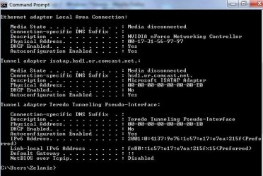

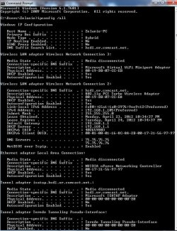

I'm sure Jacee will return as soon as she can. In the meantime can you open a command prompt, type ipconfig /all and press enter, and post us a screenshot of the result?
I'd like to see what DNS servers you're using...
Here you go.
Windows 7 Home Premium 64 bit
Thanks. Can you go back to that window, scroll up some, and post a shot of the beginning of that output?
Oh jeez- I can't believe I didn't catch that myself last night. Sorry about that.
