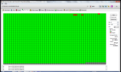

I ran HD Tune scan, see attachment.

Looks like some bad sectors.

Looks like a Seagate from that HD Tune pic?

Post a pic of the health tab in HD Tune Pro. This will tell you the number of bad sectors.
Bad sectors are usually a sign of a hard drive failing. If the number is low AND ISN'T INCREASING the hard drive may be OK (although I wouldn't trust it and would keep everything important backed up). If the number is high and/or increasing it's probably dying.

That does not look too dramatic. Why don't you run the chkdsk /r as I had suggested earlier. That might fix it.

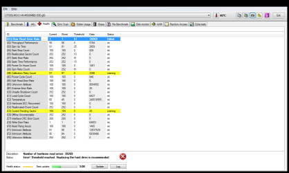

Hi I have uploaded attachment. It has got worse.
I have taken snapshots of health scan on the 27th June and today.
HD also failed seagate smart test.

I forgot attachment
