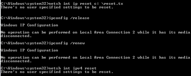

These commands were not accepted, the rest were... will wait to hear if I should proceed anyway to the next steps.

Yes do the scan some didn't work as it was no cable
