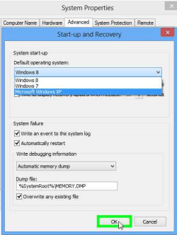

If installed as below, no need for EasyBCD
1) Install Windows XP.
2) Install Windows 7.
3) Install Windows 8.

I'm confused...
1) i don't want to install Windows 8 at all. I had a play with Win8 in town yesterday actually & i think it's horrendous, but that's by-the-by
2) In those screenshots, all those OS are installed on the same physical drive. In my case the 3 OS are installed on 3 separate drives (though i'm not sure if this will make any difference).
I've always installed:
WinXP
Win7
Win7
& every time i've needed EasyBCD to allow WinXP to boot. This time it's just not happening.
