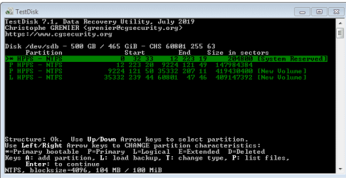

Quick question:
Is this correct? I have attached a screenshot. The * is on the 100MB partition. My Win7 was on the second one. Should i interchange them? i.e. P and *
