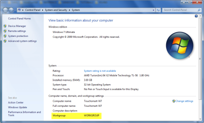

However I didnt do anything with Workgroups... would i had to have set that up? How can I tell if there is a workgroup setup?
Win 7
Windows will, by default name your Workgroup; WORKGROUP unless otherwise specified during installation. Chances are, if you don't know if you've set it up, it's WORKGROUP.
You can check the Workgroup name by clicking start > right click Computer > Properties.
You can also change the Workgroup name by (in the same window) clicking advanced system settings > Computer Name tab > Change.

Got it... they are both defaulted to WORKGROUP i will double check the time
