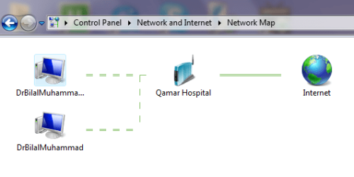

guys i am in a real trouble ........
both pc connected via wifi to my adsl router .......
but unable to see home group created in pc over other pc or vice versa
in network only one pc is visible ...
while in full network map i can see my other pc but its not accessible ...
but i can ping my both pcs eitherway ....
os is win7 ultimate
router is d link 2640t
Hi commando :) your problem there is both PC's have the same name. change one of them by clicking Start then right clicking Computer and click properies, click Change Settings next to the PC name, give it a different name, (even just putting a 2 on the end will work) at the moment Homegroup is getting confused and thinking they are the same PC
