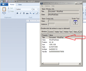

Before I forget:
On the Windows Task bar
Click on Start and type in AutoIt Window Info
Open either the 32bit or 64bit version.
Locate the Finder Tool (right side, above middle).
Drag/drop that tool on to any other window (or your desktop).
The window title should appear in the AutoIt Window Info app.
This can help you avoid typos when used as mentioned below.
In the image below, after using the Finder Tool,
double clicking where the red arrow is should put
Document - WordPad
into the Windows clipboard so that you can paste the title into your script.
Using
Opt("WinTitleMatchMode", 2)
WinExists("WordPad")
will match a window with the title of
Document - WordPad
or
Sample - WordPad
or
test - WordPad
Using
Opt("WinTitleMatchMode", 3)
WinExists("Document - WordPad")
will only match a window with the title of
Document - WordPad
You might need to use the exact title matching mode.
