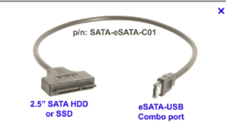

Here's a pic of the SATA==>USB adapter I'm talking about.
By removing the HDD and working with it on another machine all the lock info will have gone from the drive - and if you have to use Partition Wizard it's essentially Linux based so the HDD is just DATA to it. If it's Hardware locked then that's another problem but cheap laptop drives aren't Military strength drives with special hardware / firmware in them so I doubt whether the drive is hardware locked.

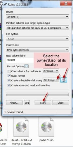

To create a bootable Partition Wizard pen drive, insert the pen drive, run Rufus, check the correct drive is shown, from the dropdown menu in "Create a bootable disk using" select "ISO Image", and then select the pwhe78.iso at its location. Click on Start to create.
When booting from this pen drive, you will get an error message "vesamenu.c32: Not a COM32R image" and it will go to the "boot" prompt. Press the TAB key and you will get 3 options linux0 , linux1, local. Against the boot prompt type linux0, press Enter and wait. The boot process will continue and you will enter into Partition Wizard. ( If linux0 does not work, type linux1 and enter. local and enter will boot from the local drive.)

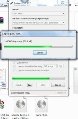

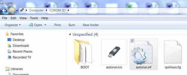

Rufus can scan and create a bootable pen drive only with the latest version of the pwhe78.iso. (With older ISOs Rufus failed to scan.) You should download the latest pwhe78.iso . I have created and tested it umpteen times. Did it again just now. Check the time of screenshots.(Rufus gives the Volume Label as CDROM for the pen drive)
Screenshots:
