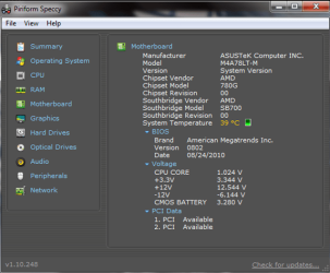

Here is a screenshot of my motherboard details.

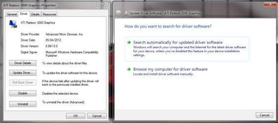

I figured the problem was with the Catalyst version I installed so I did a system restore. Everything was reverted back and working as usual. I decided to update the display drivers using windows via the device manager and that's how I discovered the problem.

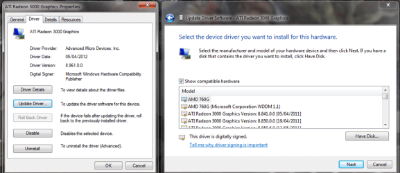

When I select "Search automatically for updated software" Windows was installing an old driver from the hard drive instead of finding a new one on the internet.

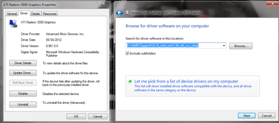

I decided to select the option "Browse my computer for driver software". I got the following window:
I then selected the option to pick from a list of drivers on my computer.
The list had all my previous drivers including the wrong driver which appeared on top. Furthermore my motherboard's chipset model is 780G not 760G.

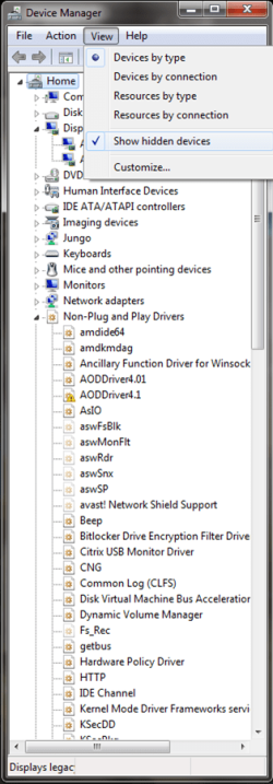

I tried a common method I found online to remove old drivers but it failed to locate them on the device manager even after I had edited the registry
SET DEVMGR_SHOW_NONPRESENT_DEVICES=1
How can I get rid of all the old drivers including this mystery one. When I unchecked the box "Show compatible hardware" I noticed that windows has a list of all the drivers including inactive ones. Where are they located and how can one delete the unnecessary ones?
