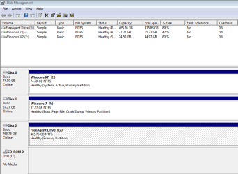

Please post back a screenshot of your maximized Disk Management drive map and listings:
1. Type Disk Management in Start Search box.
2. Open Disk Mgmt. window and maximize it.
3. Type Snipping Tool in Start Search box.
4. Open Snipping Tool, choose Rectangular Snip, click New, draw a box around full drive map and all listings.
5, Save Snip, attach using paper clip in Reply Box.
Tell us what is on each partition. We will make sure XP is bootable on its own or show you how to make it so, so that you can unplug Win7 HD confidently.
Thanks for the fast reply. I followed your steps and I think I captured what you needed.
I just have XP on one drive and 7 on the other. The main OS I use on this computer is XP and all of my personal data/documents is stored on the external.
XP & 7 Dual Boot 32bit
The System Active flags on XP tell us that it has everything it needs to boot on its own, so you can unplug the Win7 HD no problem.
If after unplugging Win7 HD a Dual Boot menu persists, enter msconfig>Boot to delete the ghost boot listing.
When you install the new HD and Win7, I suggest you unplug the XP HD.
