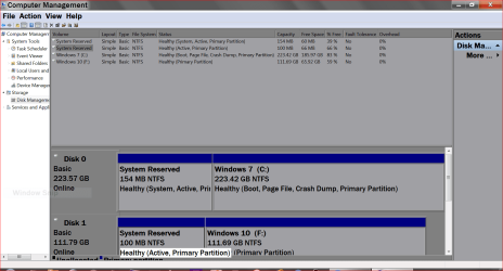

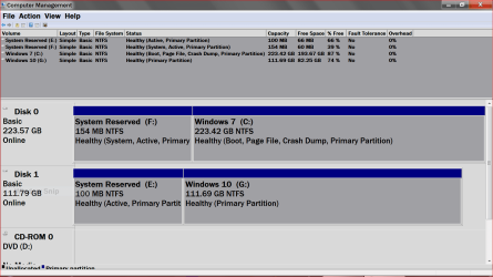

I did this just a few days ago using Partition Mini Tool.. I added and remove the Reserve partition letter from both Reserves using Disk Management.
It was quite simple to the best of my memory.
Now I have this.

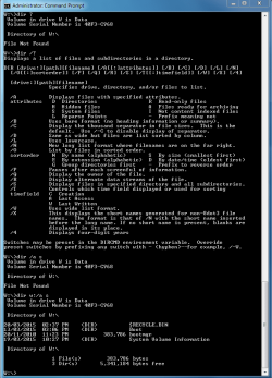

it has never had a drive letter until now. I simply followed another thread and I started computer management and selected disk management and went to properties and assigned it a drive letter so that i could see the contents in explorer.
I migrated to an SSD 840 EVO and used the Samsung migration tool .. it did all of this AUTOMATICALLY when i switched over to the SSD a year ago. I had no knowledge of this until now. I read on other threads of others having similar problems and noted that they suggested that the "DATA" label was created by the migration software. Deduced from the size of 100 MB.
I think that I will have to move the system files in this directory.
I see that they are system files... BTW how does one copy these and any "hidden" files?

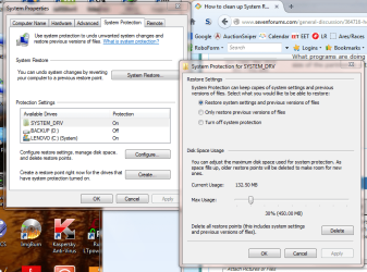

Under control panel SYSTEM => Advanced System Settings => System Protection tab, check if you have protection enabled on your SYSTEM_DRV (you probably do). Highlight it and check the 'configure' button. You probably have a large percentage of disk space enabled to be used (the slider on the bottom half). Reduce that to a smaller size.
