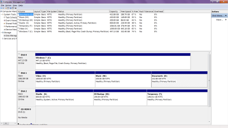

I've got myself into a mess with this.
I can easily disable sata ports in bios, so i did as recommended and disabled one w7 drive before installing the other.
The stupid thing i did was not disable other drives which did not contain any operating systems. I didn't think i would need to.
Now i have one independant W7 drive with a system reserved partition on it. Fine.
I have another W7 drive independant from the other, however it doesn't have a system reserved partition. It has dumped the bootmngr on a random non operating system drive that i use for files.
I think i understand right. This was my fault for not disabling those too, but i expected Windows to create the normal system reserved partition on the operating system disk. I don't know why it did not? This is just a normal W7 fresh install, if the other W7 drive has been disabled first.
Is there anything i can do here?
You can see from attached image that Windows 7 C: should have system and active flags, or a small system partition on Disk 0 - basically everything should be self contained and independant on Disk 0 that relates to that OS and bootmngr
Why the hell did it make my "Studio" partition on Disk 2 the system active partition containing the bootmngr?
Any help would be appreciated. Thanks

So that easyBCD method would mark Windows 7 C: partition on disk 0 as system and active, containing the bootmngr folder/files? I could then delete these from my "studio" partition on Disk 2 and my windows 7 would boot up?
Can i also do this step to copy boot files from system reserved partition on my other os disk (not in screenshot), to its C: windows partition, and remove the system reserved partition?

Once you move the Bootmgr - Move to C:\ with EasyBCD - Windows 7 Forums reboot the PC and if Win7 boots correctly with the System Active flags on C, you can mark S Inactive if it is still Active: Partition - Mark as Inactive - Windows 7 Forums.
Once you plug back in your other OS hard drive, make sure the preferred one remains set first to boot in BIOS setup, then use the BIOS Boot Menu key to trigger the other one to boot. If this isn't to your liking, use EasyBCD to add the other OS to a Windows Boot Menu.
Once it's all back together we should see another DIsk Mgmt screenshot.
Thanks
