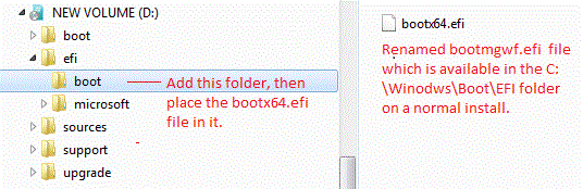

Even if your Flash Drive shows UEFI, it may not work. Check the file structure against the attachment to see if yours agrees. It also has to be formated in FAT32 to work.

Bios or firmware, whatever you want to call it, are set up differently by different manufacturers. On my Asus board, an F8, during the splash screen, will bring up a Boot Device menu so I do not have to go in the Bios for a one time choice. Del gets me actually into the Bios setup. Mine is AMI also.
The file structure is the same since I was follow this guide to install Windows 7 in native EFI mode from USB. The USB is also formated in FAT32. I just recheck all of the above.
