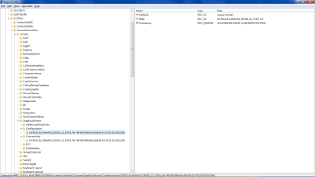

I was referring to the sub keys that apply to the active monitor (an Acer S271HL):
HKEY_LOCAL_MACHINE\SYSTEM\CurrentControlSet\Control\GraphicsDrivers\Configuration\ACR02CALUWAA01185D8_23_07E4_4A^BFDAF4B0AAA2BA361FC7F21E35503298
HKEY_LOCAL_MACHINE\SYSTEM\CurrentControlSet\Control\GraphicsDrivers\Connectivity\ACR02CALUWAA01185D8_23_07E4_4A^BFDAF4B0AAA2BA361FC7F21E35503298

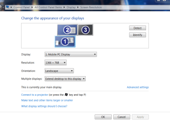

maybe im being dumb here
Once a secondary moniter is plugged in, which i do every weekend, from my personalization GUI i can change it so that either/or screen/monitor becomes the primary plus other settings ....... screenshot on its way
apoligies its from screen resolution (right click on desktop)
scrrenshot shows that my primary is my laptop screen but as i said if i hit the dropdown arrow i can change them
see the line >>>this is currently my main display<<<
note
this is from inside windows NOT my graphics GUI i assume the option is also available there...

Okay, thanks.
When you run the reg file downloaded from that website, there's no need to worry about subkeys. In fact, don't even browse the registry looking for trouble. I'm going to tell you why.
See these last two parts of the keys?
\Configuration
\Connectivity
Everything after that is included in the reg file provided by the downloded link there and my batch file takes care of all subkeys after those two paths as well. Don't believe me? Run my backup batch file I uploaded. Now look inside the two backup reg files that were created using Notepad ++ or Windows Notepad. EVERYTHING is there up to and including subkeys.
So again, don't even look in the registry. All you have to do is delete these keys via the reg file provided at that website (read the website please). But before you do, run my batch file to backup those keys. If there's a foul up ( I warned about system restore, remember?) then as an extra backup, double click on both the backups my batch file created. Here's what's in the batch file.
@echo off
reg export HKLM\SYSTEM\CurrentControlSet\Control\GraphicsDrivers\Configuration Backup_Configuration.reg
reg export HKLM\SYSTEM\CurrentControlSet\Control\GraphicsDrivers\Connectivity Backup_Connectivity.reg
exit
That's it. In the two files created, Backup_Configuration.reg and Backup_Connectivity.reg open those suckers and look. You should see a ton of crap in those two reg files that were backed up.
Same applies to the reg file in the link above. It will delete ALL keys and subkeys related to \Configuration and \Connectivity.
Again, there is no need once so ever to browse the registry unless you want to know what those reg files do. Which is fine, but peering around in the registry and messing around with it for this issue is not needed.
So, yeah, ALL subkeys are included in that reg file provided at that website and via my batch file. May not look like it, but they are.
