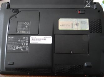

Another problem is that I have neither my windows installation serial number nor a windows cd. It came installed on the computer. The number is on a sticker on the bottom of my notebook, but it's so worn I can't read it. (See attached image). Normally, I'd use a keyfinder programme to access it on my computer, but I'm not running windows so I'm not sure how to access the registry to find the encrypted serial number, and then how to read it.

Unfortunately even if you could audit the installed key it will not work because it's the Factory mass-activation key which is different than the COA sticker Product Key used to Clean Reinstall. Your choices are therefore to order Factory Recovery disks or extract and reinstall the OEM-SLP activation file which these forums do not support any further due to piracy concerns.
So I would try everything possible to Troubleshoot Windows 7 Failure to Boot which is included in the blue link.
If you end up needing to Clean Reinstall - Factory OEM Windows 7 we have many reports that MS phone activation will replace the key if you convince them that it is simply worn off the sticker.

Gregrocker: Thanks for the info, it will save me a lot of time. I'll try the boot troubleshooter as you suggested. Then, I'll either go down the hacking route (it is my computer after all), or more likely I'll try to charm MS. It's why I included the image of the worn sticker on the base of the computer with my original post, to show that I've a genuine copy of windows installed.
