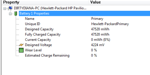

coke robot,
Use SIW (link in my sig) to determine state of the old battery.
Here's what SIW shows for my battery.

Ok, the battery wear level is 0%, the current capacity is 0 mWH, and the estimated charge remaining is 0%.
