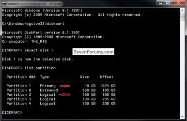

Greg has a point, when you use list partition be sure the partition Windows 7 is on is a Primary partition, if it lists as Logical this will not work and we'll need to see the snip of disk management.
click to enlarge
