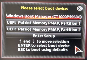

One thing I am seeing however is when booting to the Boot Menu using the hot key(F8, F12, etc) I am seeing 2 UEFI partitions to select to boot to. I have tried booting to either one but each one gives a different error shown on the screen. So my question is why am I seeing 2 UEFI partitions to select? When I boot using the same flash drive on older hardware I only see ONE UEFI partition to select which of course boots fine to the Win7 installer.

I burn the ISO using Rufus....currently v 3.20p. Settings: GPT/UEFI Gonna try and post some images.(never tried on this site before)
Below is the image I see when I boot to the Boot Menu. Notice 2 UEFI partitions.

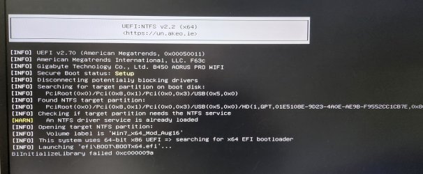

If I select the top one this is the screen that comes up.

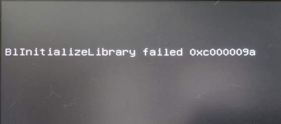

If I select the 2nd boot UEFI boot option this is what comes up and stops.
Like I said I can take this freshly created bootable Win7 flash drive and put in an older system and it boots right up to the Win7 installer just fine. I can run the installer up to selecting the drive. So at this point I'm not sure if the installer if borked due to newer hardware and not finding the correct motherboard/USB/Chipset drivers. I have tried this using both USB 3 ports and USB 2.
On the B450 system I am attempting to install(well just getting it to boot at this point) to an NVMe drive. But I have used Updatepack to add the USB3 and NVME drivers plus adding the Enhanced Menu option.
And btw the system is currently using a 1 TB NVMe loaded with Win11 that I will format if I can get that far into the install process. So it currently has an installed OS.
