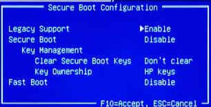

Set BIOS OS Mode Selection.
UEFI mode = Windows 7 uefi will boot, Win XP will not boot.
Legacy Mode = Win XP will boot, Windows 7 uefi will not bot.
UEFI & Legacy Mode = Both OS's will boot, but only from the One Time Boot Menu.

OK. I don't have a BIOS screen that looks anything like your picture.
And, have been through all the options in this BIOS without seeing anything that looks like that OS mode selection window.
I guess I am missing something that should be obvious, just don't know how to Set BIOS OS Mode Selection.
BIOS settings you need to both OS's to boot from the One Time Boot Menu.

You must have CSM mode set to Dual so that you can boot both UEFI and MBR format HD's. Can you confirm that?
You were wisely booting them via the BIOS Boot order and one´time Boot menu. Did a BIOS setting change perchance?

None of the screens in this BIOS show anything about CSM, or Compatibility Support Module.
Maybe thats just the way this BIOS is written?
I did not deliberately set CSM to dual. I didn't do anything to the BIOS that I know of.
I think this BIOS already supports booting from UEFI boot sources and Legacy boot sources. I think so because at first I could boot from the original HDD, win 7, called SATA0 in the BIOS, or from the new HDD, win xp, called SATA1 in the BIOS. Also, that picture in post 1 of the boot menu with 2 HDDs attached shows both types of boot sources, UEFI and Legacy.
In other words, at first I just had to select SATA0 or SATA1 from the boot menu in the BIOS.
That is called the one time boot menu, right?
And that would mean it was set to "dual", right?
