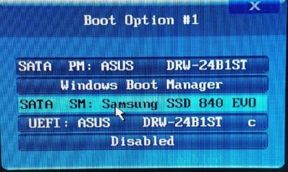

So now the part that bugs me . . . When I go into the BIOS, the three Samsung drives do not show up at all so I cannot set the boot order but I now have a "boot manager" listed and my WD and my two CD's are listed.
So the BIG QUESTION is . . . Is there a way I can get rid of the boot manager? Where is it? Only the "current" OS (default OS) is listed in the Boot Tab of MSConfig in Win-7 32 bit which is what I'm using as my primary operating system still since I haven’t installed any programs on x64 yet.
And do I HAVE to have that EFI System Partition with Win-7 64 bit? (is that another thread?)
I know you guys on Seven Forums are great. I've never not gotten good advice here even though I cam to Windows 7 way late in the game making almost all the threads old and inactive. :0)
[FONT=&quot]Thanks in advance
Edit: When I do hit F12 for the BIOS's boot menu and I select the Boot Manager I then get a screen that states something to the effect that it did not boot correctly and when I make a selection it then gives me the message "Reboot and select Proper Boot device or insert boot media in selected boot device . . ."
Edit: Now one of the Samsung SSD is showing up in the Bios. I'm not making any changes so I don't know why the Bios is changing but the other two SSD's are still missing and the WD is missing from this screen but they are all listed when I hit F12 for the boot options after the motherboard posts (beeps)
The Boot Options image is from Bios Setup.

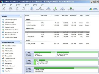

Can you post a screenshot of disk management window?

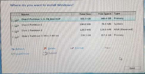

I guess I don't have a stable install yet. If I select the Boot Manager From the F12 Boot Menu it wont boot into anything. It says "reboot and select a proper boot device or insert a boot media in selected boot device . . ."
I again disconnected the Win7 and XP drives and tried to boot but got the same message so I inserted the Win7 64 bit disk and tried to run "repair" but got the message: "This version of System Recovery Options is nor compatible with the version of windows you are trying to repair".
If I try and reinstall I get the following screen . . .
I'm tempted to delete all three partitions and start over but should I delete them here or with Easeus Partion Magic or some other method. I'd rather not have these THREE partitions.

Basic Rule: When installing a OS on a disk, ALWAYS detach ALL other disks (detach SATA or power cable)
As you already have Win 7 64 on disk 1, try this:
- Detach ALL other disks (detach SATA or power cable) leaving on only disk 1 (Samsung 850 Pro 256GB SSD) and the ODD drive.
- Boot from the Win 7 installation disk as UEFI, go to repair - Do a boot repair.
- It will create EFI boot loader that will take you to the Win 7 64.
The Win 7 installation disk can be booted as Legacy or UEFI (two options on boot menu). Look at your picture of boot menu:
- fist (SATA PM Asus..) is legacy mode
- 4th (UEFI: Asus...) is UEFI mode
You have:
Disk 0 (win 32) is MBR - Legacy
Disk 1 (win 64) is UEFI - GPT
Disk 2 (win XP) is MBR - Legacy
Disk 3 (Backup) is MBR - Legacy

I took the time to delete all the partitions and reinstall to a clean disk with no other drive connected.
The install went without a hitch and I could boot into it at will but as soon as I re-connected the other drives and booted into one of them I could no longer boot into Win-7-64-bit. To wipe the drive and reinstall only takes about 30 minutes.
When I try to boot into it it just stalls and boots into WinXP. If I disconnect XP it boots into 7-32-bit If I disconnect that as well it just wont boot at all.
I'm stumped.

I've managed to fix it two more times but every time I hook up the SSD with Win-XP on it, it brakes the boot system for 7-64 and I have to run system restore. I cannot for the life of me figure out how this can be happening. I've spent hours installing drivers and security updates and setting preferences this time so I hope I have enough restore points that I wont ruin it trying to figure this out. I've been going back and forth between 7-64 & 7-32 all day with no problems as long as I keep the XP drive unplugged.
One really strange issue is that Windows Disk Management shows two partitions, AOMEI Partition Manager shows three partitions and EaseUs shows FIVE partitions on that Drive. What the heck is this about?
The boot menu has changed as well. It now has a selection for UEFI: Samsung SSD 850 PRO 256GB. If I select the SATA version of the same drive the boot fails with or without XP. If I select Windows Boot Manager it fails as well and asks me to provide a bootable device (paraphrased)
Is this Boot Manager NORMAL for a UEFI install of a 64 bit OS? I read somewhere that it is. It sure is annoying. Can this boot manager be edited so that if I select it I get some valid options? If it's going to be there it ought to do something besides asking me to provide it something bootable. I have only a little experience with bcdedit.exe (just used it to rename OSs)
Thanks for listening
John

As I already described, you have two kinds of disk low level format: MBR - Legacy and UEFI - GPT.
The disk 1 and 3 are MBR - Legacy and disk 2 is UEFI - GPT.
You made a big mess when installing Win 7 64 on disk 2. Fist of all, you have used a program to partition the disk and that is why you have two unallocated partitions. It is not necessary to use this kind of programs as Win 7 installation wizard will do it for you.
My suggestion: Reinstall win 7, making the disk 2 Legacy
- Detach Disk 1 and 3 (SATA cable or power cable)
- Normally boot you win 7 installation disk (not UEFI boot)
- Go to install, advanced, delete ALL partitions- create new.
- it will create two partitions:
- 100M MS reserved - RAW
- A big NTFS
Install on the big NTFS
It will install Win 7 64 on disk 2 as MBR - Legacy, so all disks will be the same type (MBR - Legacy)

I hope your solution works but I did not use any program to partition the disk. It was a new disk and I only used the partition program to look at it. I did however format the disk with Windows Disk Management console before installing 7-64-bit. On my second install attempt I did as you suggest and selected "delete ALL partitions" before installing.
I will try it again and reboot after deleting all partitions to make sure they are in fact deleted. I dont remember doing that last time.
Now that its running good with all MB drivers and updates and personal tweaks (without the XP disk installed) I will first try and back up the Windows installation with Acronis TI and do as you suggested . . . and then restore the backup but NOT the boot sector (not the entire drive of course)
I'll wait a while to see if you have a reason to not do that backup/restore.
Thanks for hanging in here with me.
