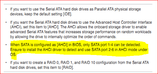

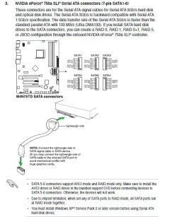

You have it connected to SATA port 5 or 6? If not that would be why it isn't working. from the manual for your motherboard,

yeah its connected to SATA port 5, at first i actually DID miss that, but yeah its connected to the RAID/AHCI port only

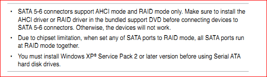

If you haven't try it on ports 1-4. I have a feeling that 5 and 6 may support AHCI and RAID, they operate on your board the same as mine. This is from the manual for my board,
Basically means that 5-6 are not available as boot drives and not seen by the bios when AHCI is enabled, but they can be seen and used by the OS. I have my storage drives connected to them on mine so that they can't be seen by Windows when installing, other than that they are there once Windows is installed.

ahhhh ok now we're getting somewhere a little bit then.. Because i thought it was saying IF YOU WANT AHCI, place them in those two ports... ok well when i have them in the 1-4 ports yes sees the drive no problem, but the issue is its only in IDE mode, the SECOND i change that to the AHCI mode or RAID, it will not see the drive anymore, at all, when i try to install windows, i get the error message "windows cannot be installed on this device, make sure the correct device controller has been installed"
If i can just get the AHCI drivers installed, i can probably get this thing to work ok... but when im in AHCI mode, the bios just refuses to see anything but a cd/dvd drive
