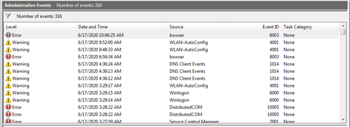

Event Viewer Shows the following
Event ID 1014, DNS Client: Name resolution for the name isatap.hsd1.ga.comcast.net timed out after none of the configured DNS servers responded.
Event ID 1003, Dhcp-Client: Your computer was not able to renew its address from the network (from the DHCP Server) for the Network Card with network address 0x68A3C4895A7B.  The following error occurred: 0x79. Your computer will continue to try and obtain an address on its own from the network address (DHCP) server.

Ok, I took the time to just observe the issue frequency.
In Event Viewer, the issue(s) are happening every 2 to 5 minutes. This frequency seems to be when I have a web browser open.
Also, Event viewer shows some of them to be a little less frequent, every 5 to 10 minutes, when a web browser isn't open.

Um...I'm not sure what happened...
I went to bed around 3:45am this morn and woke up at about 9:00am. Open my lid and noticed a better more stable connection. I then created a Restore Point in System Protection via Control Panel.
I opened Xirrus Wi-Fi Inspector and noticed the router channel had changed from channel 6 to channel 1.
On Monday the 15th, I deteted 4 items from the registry via the instruction at the following link...
It seemed to have little to no effect.
I've made no other changes after that.
