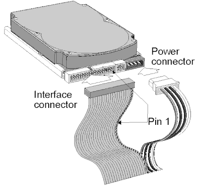

Why are you using the term "Ribbon cable" ???
What do you mean the slave drive "booted up" ??? What exactly is on this drive ???
I think the OP means cable.
Me too. But I note many SATA cables are flat and so may appear to some as ribbon cables - or close enough to call them that.

Taking some pictures might be better than words :)
Ribbon is usually a very old hard drive connection.
