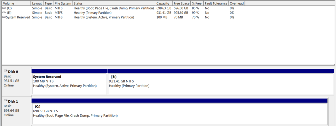

I have two disk drives on my computer, Disk 0 and Disk 1 (see attached screenshot). Disk 0 has two partitions, System Reserved and E:. Disk 1 is given over to the C: drive.

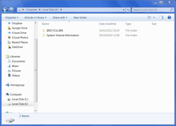

E: only has Recycle Bin and System Volume Information on it (see attached screenshot).
I want to delete the E: partition in order to create unallocated space to install Linux. Is it safe to do so?

Sure, there's no data on it.
Your disk configuration is a bit odd, the loader is on drive 0 and the OS is on Drive 1. Everything will work as long as both drives are in the machine.
It's usually better to have both the System Reserve and the OS on the same drive. I'm not sure of the best way to change it though other than a clean reinstall with only one drive in the machine.

You simply mark disk 1 active using disk management, then unplug disk 0, then run startup repair until disk 1 (C) boots on its own.
Then I would move the sata cable from disk 1 (C) to the 1st sata port on the motherboard. (Sometimes labeled sata 0)
But back to your question, Yes it`s safe to delete E but don`t touch the System Reserved partition or Windows won`t boot anymore.
If you apply the fix I described above, then you can format the entire 1 TB drive and do whatever you want with it.

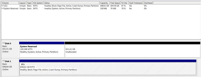

Here's an update!
I asked a computer expert to come and help me do the things you suggested.
He changed the boot partition to the C: drive using EasyBCD (which he put on my computer for me!), but he didn't swap cables so C: is still on Disk 1. He also deleted E: from Disk 0.
He advised me to keep the System Reserved partition on Disk 0 as removing it could cause major trouble. Was this advice correct?

This so-called "expert" did nothing that I can see. He did not move the Bootmgr - Move to C:\ with EasyBCD - Windows 7 Forums or it would be labeled System. You can do this yourself since the steps in the blue link are easy to understand.
Then power down to swap the data cables between hard drives so that C is now in Disk0 slot, set as first hard drive to boot in BIOS setup. Keep the other hard drive unplugged until you are sure C can boot on its own.
Then power down to plug back in the other hard drive, wipe it with Diskpart Clean Command to clear the System Reserved partition but most importantly boot code on the disk which can interfere later. You can then partition it as desired in Disk Mgmt: Partition or Volume - Create New
At all times make sure C hard drive remains set as first HD to boot, or Primary hard drive. This can be achieved easiest by swapping the data cable from the old System Reserved drive to C, since you want it in DISK0 position anyway so that the boot files cannot again be derailed during a Repair or Reinstall to the first available Primary partition on any preceding drive.
