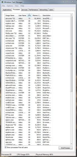

Hi and welcome
can you open task manager (right click the task bar) and use the snipping tool (biolt in see pic) to make a scfreen shot of the process tab. Make sure you have the all users checked. To attach teh snip use the attachment icon see other pic

hi, thanks for the rapid response.
both my machines running running windows 7 have this problem
here is the capture.
It is not a server machine so i dont think the sever thing applies.
