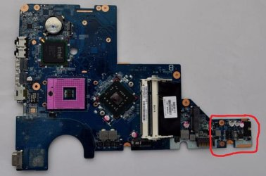

Sounds like you may have a charging circuit issue on your MoBo. I have a laptop that won't charge the battery and it won't turn on with charger plugged in, with or without the battery. I'm going over the schematic on the charging circuit to determine what components I need to test/replace.

I've tried blowing some air into the charging connectors see if there was something stuck there blocking the charge.
Do you know where the charging circuitry is usually located on a motherboard?

The charging circuitry is usually located close to the external connector on the MoBo. It's a small section. On my laptop I disassembled it's circled in red. Try a little googling on the subject. Here's a pic.
