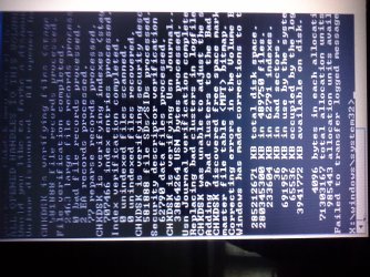

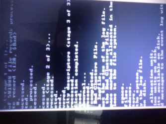

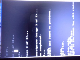

A hard disk problem is preventing windows from starting. I got pixs for the chkdsk on the c dr. Unfortunately only one third of my screen is visible. My lappy has been through a good deal and screen is worn. So the pic is in 3. Sorry for that. And the chkdsk for the e drive is saying this : chkdsk cannot run because the volume is in use by another process. Chkdsk may run if this volume is dismounted first. All open handles to this volume would then be invalid. Would you like to force a dismount?
I will run the sfc shortly.
Yes .. force the dismount and do chkdsk/f e:

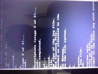

This the result of the chkdsk/f on the e drive. Hopefully it comes out in order.

Many bad blocks. Run the command again. No more disk errors? Reboot and do it again.. no more disk errors?

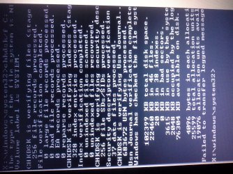

Still getting the same results.

Your harddrive is dying!! Backup important stuff asap. Buy a new harddisk!
