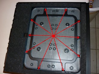

Here is the original panel from the inside and showing how the grille was attached using tabs which I bent and it came right off.

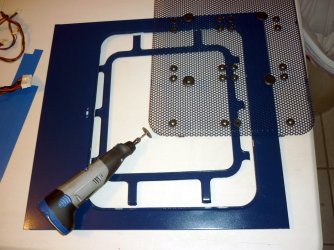

After cutting.

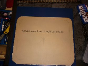

I got a piece of acrylic (Acylite) 3/16" thick for the window and made it to a very rough shape. Then I used a jigsaw with a laminate cutting blade which makes a smooth cut to refine the corners.

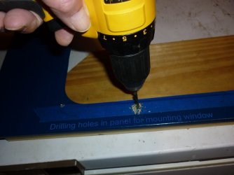

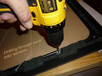

I laid out and marked on masking tape where I want the mounting holes and drilled into the metal panel. I used it as a template to drill matching holes in the window. I taped the window to the panel with duct tape to keep it in place.
I found out one needs to drill acrylic slowly or it will break out, like wood splinters. Fortunately the finishing washers under my screws cover it up.

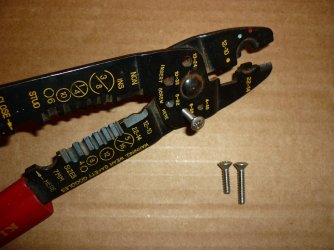

I had to use this electrical tool and cut my screws to the exact length I wanted so there wouldn't be a long part sticking out the other side.

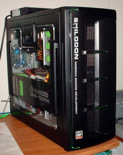

Custom molding plastic sheet is very expensive plus I would have to make a template to mold it to.
I don't mind the window on the outside at all, many cases are made that way, including my old one.

for future drilling, heres a couple of tips, you can drill a small hole with a smaller drill bit then widen it out with the correct size bit you need,
you can buy drill bits specially for drilling perspex .
just before you drill through to the other side ,you stop drilling and turn the sheet over and drill from that side.
it can also help prevent cracking if you clamp a scrap piece of perspex on top of the sheet and drill through both,
and finally if you put some duct tape over the point you want to drill this can also prevent cracking.
and as you already said drilling slowly will also prevent cracking and heat damage.

Thanks Julian, I did have the back side taped when drilling. If you drill into a small hole with a bigger bit it will grab the hole and break it out in plastic, aluminum acts the same way at times.
I had no scraps of acrylic but had a wood backer on though.
