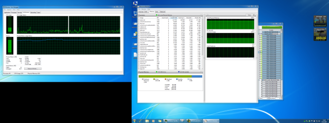

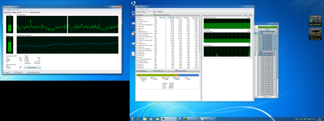

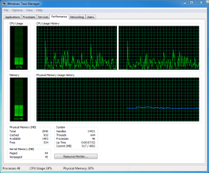

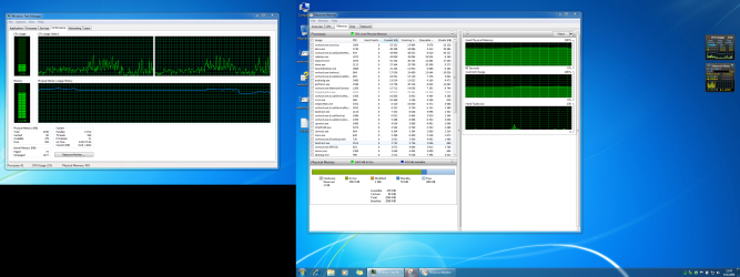

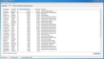

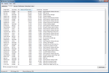

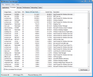

So here are screenshots. I could download only 5GB today so the RAM was not comnpletely full, but still something consumes a lot of it.
Before2,Before3.png are screens from before starting jdownloader
During1,During2.png - during downloading
Before Closing1,2 - after download finished (after i exceeded rapidshare download limit for today) before closing jdownloader
after closing1,2 - after i closed jdownloader - here you can see that somethings consumes a lot of RAM but it is not shown in task manager

You are misinterpreting the data. Nothing presented indicates a problem. In order to address your concerns, I will compile a list of references available here at SF and some other links. That will take me a while because it is not critical.
The RAM is being used by Windows, not your downloads. Riddle me this - when you are downloading, you can easily perform other activities, right?
If not, I would be more concerned with the high CPU usage that seems to be required of your download app.
During and after downloading i can run other programs but the whole system is due to no memory slowed down. It is like if i would be running photoshop, paused virtual PC and firefox (which can use up to 500MB with all my extensions). Then for example chrome is starting even 20s instead of 0,3s -before downloading; and it is not caused bu CPU but by swapping because no memory and I dont have fast SSD but normal hard drive so it is all slowed down until I reboot
