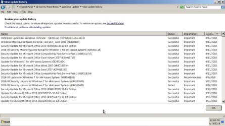

Well, this all happened it seemed when I got 1 download "important" it said, from Microsoft so I put it in.....
Then all this crazy stuff happened...
I was going to write to my nice helpers here at WindowsSevenForum (as searching Microsoft in my primitive methods I could not find anything wrong with the update/download to worry me so I took it in...I always wait a while and check to be sure that nothing BOLD bad is happening to others who take the same download)
Anyway... I quickly got I think it was 7 (!) new important downloads from Microsoft. I didn't have the time to research each one....and assumed it was because the one I did caused so much pain and misery with others.... some with me...that they quickly made a patch...so I took all 7 in!
THEN i got messages from places like "Windows Defender" (which I did remember turning off..but the latest patch turned it "on" ? how is that possible ? without asking me first?? :confused:

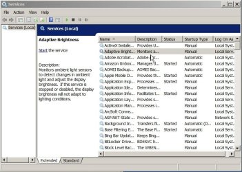

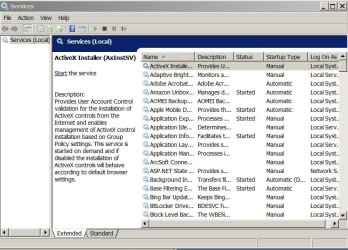

Services under Administrator Tools
Microsoft.NET. I have changed it to manual
I have so many different .NET's
Many of the programs I use and frequent have different .NET requirements! Whenever one says its old or outdated I am instructed to follow links to Microsoft and download the latest .NET framework (aha, see? I recalled that word just now) . They use it for something...in GUI not sure what...
I'd like to change it to manual if that helps...but since I have no idea which programs are using it (I can't just type it in the search bar, correct? and ask the computer so which one of you 300+ programs really needs to have the .NET framework on auto and not manual! Until I turn it on a month or three from now and wonder "why" its not working.

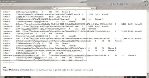

Another thing you could try, is have a look in the Resource Monitor in the "Disk" tab to see which process is reading/writing to the hard drive so intensly. To open resource monitor, hold down the windows key on your keyboard and press "R" (win+r) in the "Run" dialogue box that appears, type in "resmon" and press enter.
Thanks for the suggestion and description of how I do it
Ok did and done....
All say "normal" in both Safe Mode and Regular mode.
I'd post screen shots but you know the list is huge and would cover many screens... Can I copy and paste the list?
I guess I can!
But its NOT in neat columns like
I tried to re-format the copied stuff using comma delineated word processing....sorry took too much effort to straighten it out... anyone got short cut to make the columns line up automatically without hand doing each line?
I hate doing this to nice people like you but here is the "Data dump" of the copy and paste----- GIGO
Safe Mode listing for "Disk" tab;
Image PID File Read (B/sec) Write (B/sec) Total (B/sec) I/O Priority Response Time (ms)
System 4 C:\ProgramData\Malwarebytes\MBAMService\config 0 69 69 Normal 44
System 4 C:\Users\ 0 81 81 Normal 43
System 4 C:\Users\\AppData\Local\Google\Chrome\User Data\Default\Current Session 0 5,077 5,077 Normal 17
System 4 C:\Users\\AppData\Local\Google\Chrome\User Data\Default\Cache\data_2 0 6,729 6,729 Normal 17
System 4 C:\$BitMap (NTFS Free Space Map) 0 206 206 Normal 15
chrome.exe 2036 C:\$LogFile (NTFS Volume Log) 0 1,570 1,570 Normal 12
System 4 C:\Users\\AppData\Local\Google\Chrome\User Data\Default\Cache\data_3 0 24,869 24,869 Normal 12
System 4 C:\Users\\AppData\Local\Google\Chrome\User Data\Default\Cache\f_001e18 2,048 23,488 25,536 Normal 12
chrome.exe 2036 C:\Users\\AppData\Local\Google\Chrome\User Data\Default\Cache\data_2 549 549 1,097 Normal 8
System 4 C:\Users\\AppData\Roaming\Jarte\Document Backups\Crash Recovery Files\Current Session\Windows 7 on JARTE re Excessive Read Write overloading HDD 4-15-18 C JARTE - c0866d51-9890-496c-84b0-5fea27aa9a55.rtf 8,192 80,896 89,088 Normal 8
System 4 C:\ProgramData\Malwarebytes\MBAMService\config\MbamClientConfig.json 0 9 9 Normal 7
System 4 C:\$LogFile (NTFS Volume Log) 0 4,370 4,370 Normal 5
chrome.exe 2036 C:\Users\\AppData\Local\Google\Chrome\User Data\Default\Cookies-journal 546 7,100 7,646 Normal 5
System 4 C:\Users\\AppData\Local\Google\Chrome\User Data\Default\Cache\data_0 0 4,369 4,369 Normal 5
chrome.exe 2036 C:\Users\\AppData\Local\Google\Chrome\User Data\Default\Cache\data_3 866 866 1,733 Normal 4
System 4 C:\Users\\AppData\Local\Google\Chrome\User Data\Default\Cache\f_001e17 1,365 1,451 2,816 Normal 4
System 4 C:\Users\\AppData\Local\Google\Chrome\User Data\Default\Cache\data_1 0 5,413 5,413 Normal 3
System 4 C:\Users\\AppData\Local\Google\Chrome\User Data\Default\Local Storage\leveldb\000216.log 0 256 256 Normal 3
System 4 C:\Users\\ntuser.dat.LOG1 0 939 939 Normal 3
System 4 C:\Users\\AppData\Local\Google\Chrome\User Data\Default\Cache\f_001e16 0 5,675 5,675 Normal 3
System 4 C:\$Mft (NTFS Master File Table) 0 1,029 1,029 Normal 2
System 4 C:\Windows\System32\LogFiles\WMI\RtBackup\EtwRTDiagLog.etl 0 341 341 Normal 2
System 4 C:\Windows\System32\config\software 0 223 223 Normal 1
System 4 C:\System Volume Information\{80d8e26a-40b3-11e8-9051-f07bcbe10be0}{3808876b-c176-4e48-b7ae-04046e6cc752} 0 8,192 8,192 Normal 1
chrome.exe 2036 C:\Users\\AppData\Local\Google\Chrome\User Data\Default\Cookies 0 6,895 6,895 Normal 1
System 4 C:\Users\\AppData\Local\Google\Chrome\User Data\Default 0 202 202 Normal 1
chrome.exe 2036 C:\Users\\AppData\Local\Google\Chrome\User Data\Default\9cbf2757-fe14-4b6b-ba79-27436cbd1c23.tmp 0 15,565 15,565 Normal 1
System 4 C:\Users\\ntuser.dat 0 478 478 Normal 1
System 4 C:\American Systems BF SAVING FILES 1 0 69 69 Normal 1
chrome.exe 2036 C:\Users\\AppData\Local\Google\Chrome\User Data\Default\be2789f9-1519-43c9-8a55-af46af8a00ab.tmp 0 12,288 12,288 Normal 1
System 4 C:\Windows\System32\winevt\Logs\Microsoft-Windows-NetworkProfile%4Operational.evtx 0 68 68 Normal 1
System 4 C:\Windows\System32\config 0 614 614 Normal 1
System 4 C:\Windows\System32\config\system 0 446 446 Normal 1
System 4 C:\Users\\AppData\Local\Google\Chrome\User Data\ShaderCache\GPUCache\data_1 0 73 73 Normal 1
System 4 C:\Users\ \AppData\Local\Google\Chrome\User Data\Default\GPUCache\data_1 0 76 76 Normal 1
System 4 C:\$Extend\$UsnJrnl:$J 0 34 34 Normal 1
svchost.exe (LocalServiceNetworkRestricted) 852 C:\Windows\ServiceProfiles\LocalService\AppData\Local\lastalive0.dat 0 15 15 Normal 0
System 4 C:\Windows\System32\config\SYSTEM.LOG1 0 646 646 Normal 0
System 4 C:\Windows\System32\config\SOFTWARE.LOG1 0 844 844 Normal 0
and

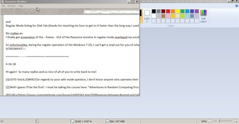

Regular Mode listing for Disk Tab (thanks for teaching me how to get to it faster than the long way I used to use!)
No results as:

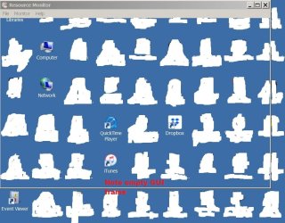

I finally got screenshot of the --frame-- GUI of the Resource monitor in regular mode overlayed my word processor that is why you see the results of the Safe Mode version in it
So unfortunately, during the regular operation of the Windows 7 OS, I can't observe and copy off a read out for you of what is going on and if anything is not "Normal" as in the Safe Mode above.
I finally got screenshot of the --frame-- GUI of the Resource monitor in regular mode overlayed .jpg
and after writing the words I wanted to post , I had to go back into Safe Mode to turn on the browser and post to the WindowSevenForum site.
So I took one more Screenshot showing that No matter how long I kept Resource Monitor up it never showed anything so I quit trying note my draft copy of what I wrote to you is "under" the window.
No matter how long I kept Resource Monitor up it never showed anything so I quit trying note my .jpg

Was that messed up copying and pasting the results from using Resource Monitor in Safe Mode that I did in Post # 22 ok to read? Everything said "Normal" which I assumed was the most important item you all were looking for.
I put this all at end in case anyone wants to skip it.

OK I feel emboldened!
I went WIn+R
typed "resmon" for Resources Monitor and....
It still DOES NOT FUNCTION! Only the empty GUI window frame appears showing whatever is under the window. See Screenshot I did using my desktop as a background instead of the word processor as maybe you didn't understand what I was looking at or wanted to show (see above Resource Monitor screenshot very well hidden in Post # 22 to compare....both show it not functioning! I do have "other" objects doing same thing...
OK so I posted BOTH screenshots here for you to compare as they show same problem!
so it might be signs of something still going very very wrong with my laptop!
So this is not marked "solved" just yet...
But we're really really close!

See the following three series of Screenshots I took of my many "Services" which contain too many pieces of information for me to type as I found out and you can see my attempt at trying to copy this information and paste it.... Typing it by hand line by line is forever!
(Just noticed I copied by accident in the above screenshot: "Windows Defender" says it "stopped" but since I have two other AV's that should be deleted? or Cancelled? or whatever setting it should be as it was jolted awake by the latest series of Windows 7 Updates).
Typing a list of Services to share p 2 services with information PS35531.jpg
Typing a list of Services to share p 3 services with information PS35532.jpg
I always have to write it down on paper or use a Notepad to copy it off into the small window before moving to the next item in these types of computer internal listings...

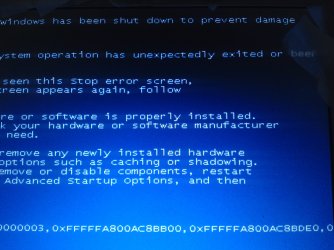

Using Google Chrome now that it 'works" I opened too many windows I guess as I vainly struggled, attempting to catch up on everything I’ve not done for past week or two that I've had a non-functioning PC and still have work that can only be done on it/online.. All in one day? Yes!
I got low memory warning and “bit mapped window not found” or something like that no screenshot as its not working either....
I closed programs (chrome shut down all by itself) to get out of this problem and shut down computer. The words “shutting down stayed on screen for a while... maybe 10? 20 minutes...
Then all ok and all dark. I let everything cool off for an hour or so before re-starting computer
On start up of power button
Says “Starting Windows”. Always a good sign to see four colors and window....
Never got to desktop

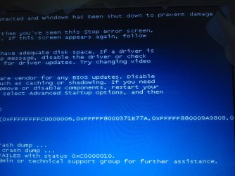

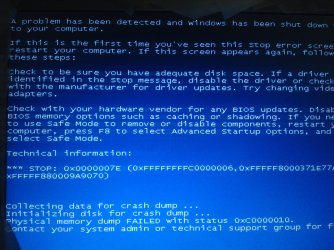

I got the BSOD!
“ A. Problem has been detected and windows has shot down to protect damage to your computer”
Ill try to post a screen shot with a camera!
Done! See the two below:
At end collecting data for Crash Dump
Initializing disk for crash dump
Physical Memory dump FAILED w status. 0xC0000010
(I’ve looked them up before...it’s always. “Some unknown error” so lots of help from the Microsoft data base!) :lol:
Says:
Contact your system administrator or. Technical service group for a solution.
I.e. you?
So I’m back here for the experts who are better than Microsoft.
So I shut down computer again.

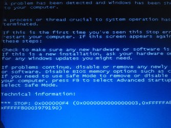

Going in and out of Google Chrome browser and turning off the Laptop when I get memory warnings... caused these BSOD's to appear upon one of the start ups today
and I'm adding them into the current list of BSOD's I receive until the computer just does not work anymore....... sigh....
Here they are from camera photos:

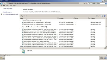

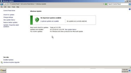

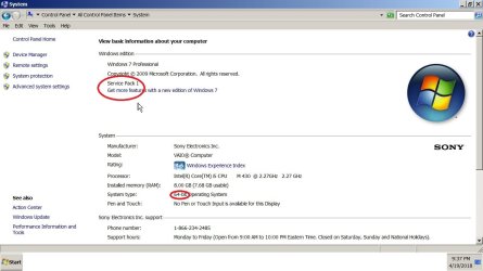

I have:
Did I miss an important update with SP2?
Everyone! Maybe that is why my whole system is malfunctioning! If I'm behind on an important update, but the screen just says "optional updates" no more "important updates : (I can provide that screenshot if someone says I really missed SP2 for Windows 7! And this is why everything is crashing around me!
Thanks for answering this Megaherz07!
I am confused so I dumped a whole bunch of screenshots here....
I have two different locations it seems for holding "windows update items"
I can['t even begin to search for the KB items you mentioned in your link above: MS releases SP2 for Windows 7 - Windows 7 Help Forums
I'm just a mini-geek lost in the weeds here... bowing down to the superior forces that know their way through this maze.
(I always "looked" but never really memorized what items were here or why I downloaded each one...just approved each one as long as the Microsoft sites said they were "ok" free of bugs and viruses to download and use them)

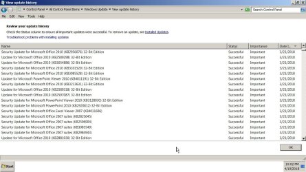

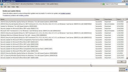

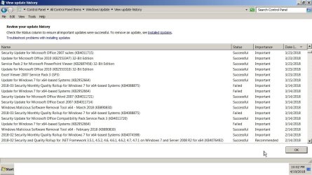

Screenshots!
(I stopped doing this! I can't cut and paste everything at once....and doing it this way a few at a time... I probably duplicated some of them and I can't even know that for certain I'm not good at this detail work.....
AND I only went back to December 31st 2017... do you know how far this history stretches back to? Because I don't. One screen slowly loads at once (you can't go to "last" or "first" as in the Windows Seven Forum Website (unless I missed a button somewhere here ---stupid me!).....
