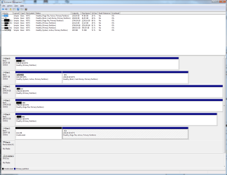

This is the current screen shot.

Joshua. Your Disc Management shows that both the SSD's we are talking about only have about 20% free space. This is simply not enough for an SSD, they need at least 10% for Over Provisioning, which is commonly meant as garbage collection. So that only leaves a 10% margin which is not enough for various file expansion in the normal course of Windows operation.
Either you will have to reduce the number of programs you have loaded or you will need to get a larger SSD.
Then we can look at getting your current system working properly.
From what you have said you can boot into your old SSD which is disc F & it has the Chinese writing for System Reserved is that correct?.
