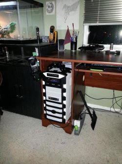

Yeah I will probably end up pulling it apart and trying to fix it because I was planning on using it in another computer. Do you think just some fresh thermal paste will do the trick? Seems a little too simple.
And actually the machine is off the floor and tucked away so I don't know how it got so bad. I do have dogs so that probably played a major roll. I will attach a picture just for the heck of it, it looks cramped but there is plenty of air flow and my temps are normal.
