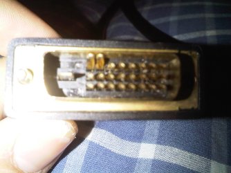

It seems is the cable. I've tried connecting the cable in another monitOr and it yielded the same results: no image displayed nor the monitor was detected. I'll be ordering a new cable soon and I will tell you afterwards.
A friend's theory, which it seems right. It seems that the cable has several pins broken (which at clear eye doesn,t seem so) and the xbox 360 DOES NOT need those pins either to detect the monitor or to display the image.
Although crazy, let's see what happens when I receive the new cable

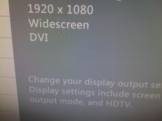

Yeah, I tried :cry:. Dozens of times. But there are several statements to point out:
First, I need to have something connected for the monitor to show up the menu. (Which I use two 360s to do the job)
Second. I've tried using the force output with the Nvidia settings (to see if something comes up, including the TV output setting), but nothing!
Third. I've learned that the cable I just got, does convert the video signal to HDMI. I mean, the other cable had different pins than the one I got, and when I went to the 360's display settings it said DVI. Now with the new cable it says HDMI....
Better show you some pictures:
Cable 1 is the old cable.
Cable 2 is the new cable.
DVI is shown on the configuration on the 360 (Cable 1)
HDMI is shown on the configuration on the 360 (Cable 2)
I'll keep monkeying around with the settings to see if I can get to something... Again thanks a lot for the fast replies.

Is it possible that when the pins were bent on the old cable that it damaged the connection on the video card? Can you get us a good close-up shot of the card and its connections?
Well it is a laptop.... If you want, I could disassemble it an take a picture.... But just to say that the motherboard was replaced 4 months ago, and yes, the video card comes bundled with the motherboard.

What I'm getting at is a picture of the connector where the monitor gets plugged in. I'm wondering if when the cord was yanked out and the pins were bent that it might have messed up the socket.
Being a laptop, something that pulled hard enough to bend a couple of pins might have also pulled the entire laptop off the desk. Is that possible?
Pulling the entire laptop off the desk was not possible due to the reason that it has almost no exit. It must have been a very long journey for it to fall. Plus, none of the cables were disconected, and I am the only one in my entire house who knows how to deal with them...
Anyways, I'm addressing you the pics with the connector.... Thanks a lot for the fast replies and the great help!
P.S: Sorry for the bad quality pic... It was taken from my cellphone...
Edit****************************
By The Way, the cable which was disconnected was the DVI end, the laptop was unscathed.

Can't see anything cracked.
What is the exact model of the laptop?

No. That was the Monitor's connection.
This is the laptop's:
BTW it is a Dell XPS M1530 with Nvidia Geforce 8600M GT.
I'm currently using a DVI - HDMI cable

Are there any problems (red "X" or Yellow "!") in Device Manager? While you're in there, what does it show under Display Adapters?
Most laptops have a utility down by the clock to adjust video settings. Do you have anything like that? (It may be a hidden icon.) What is the name of the utility?
In Control Panel under Display>>Adjust Resolution does it show the monitor at all? (Make sure it's connected and turned on.) ;)
Nope. Only a Bluetooth driver, which I am lazy enough not to update, since it's working fine.
Nvidia Control Panel. Aside from that, there's nothing.
No it does not show anything. Only the VGA output, which is not connected. I even tried forcing it out, by forcing detection and output. But got no results.
Thanks again :) for keep helping me to solve my issue.
Edit*****
Oops. Forgot to attach the images

Profdlp. I just solved the problem :D (Finally!!!) I did (again like for 3rd time) what you just suggested me with the new cable: Uninstall the display drivers, and reset the computer with it. I did it, and now it is working like a charm.
Thanks a lot for helping me this out. :D
