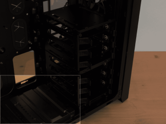

So.. Since my weekends these days seem to be filled with anything and everything except building my monster, I decided to start putting it together tonight instead.![]()
...and I've already run into a few issues. The gorgeous Corsair fans I got are all the 3pin non-PWM type, which I just noticed will not work with my ThermalTake cooler. I just ordered two SP120 PWM versions from a local PC store, so I should hopefully get those before the week is out, but I do feel somewhat daft for not thinking of that previously.
Also, it seems the mounting holes on these SP and AF fans are far from sturdy. Already broke one of them trying to cut into the fan plastic with one of the standard fan screws. Looks like the corner pieces can be removed, so I can flip it around and use the other side, and since the front case fans and the two on my radiator use long screws that go into a metal plate behind the fan, they're safe.. I just hope I can get the case fans mounted without causing any further damage.
One very sad panda right here..![]()
Try putting a little bar soap on the fan screw threads before screwing them into the fans.
ZaLiTH that bar of soap trick has been around for hundreds of years.
It started to the best of my knowledge when driving nails in hardwood like oak. They soaped the nails so they could drive them without bending the nails.
I have had many brands of fans and never had the problem you are having. Try using another set of screws. One set could of been made out of specs.
Corsair fans have sad reputation for breaking at the screw holes (I've seen a lot of complaints about that in reviews and on the Corsair forums). Soaping may or may not help but it costs little to nothing to try.
...While turning in the screws, the whole rubber section in the corner twists and bends horribly.. I'm hoping that holding it more firmly will help a bit with getting the screw to cut in more cleanly. Times like this that I really miss that darn left hand..
