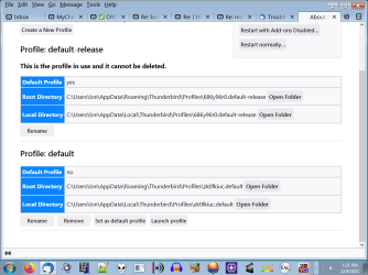

I know the instruction of getting to the Profile: START > %appdata%\Thunderbird\Profiles
But there is a profiles manager under another sub menu which I can't handle.

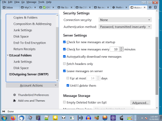

I have made a screen shot of the relevant Account Settings since I don't know what else could have any effect.
There may be other things to tweak, I just don't know any.

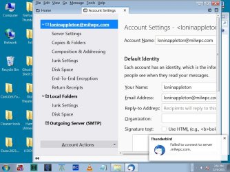

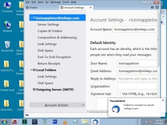

I have duplicated settings to the best I can from my regular T-bird Account settings.
Ther error received is failure to connect to server
I can't do any more. If there is not a simple fix after this I'm going to close the topic. It's too frustrating. It's not fun
to work on where the 'everything you know is wrong ' message pops up.

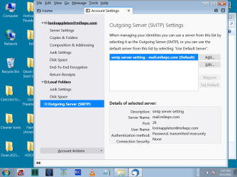

The attached screen shot shows settings on the T-bird Portable 78 which installed to the desktop. Maybe I wasn't watching closely enough for it to be installed in Programs.
The screen shot is for outgoing server settings. Everything is duplicated from the Thuderbird main install including the change to SMTP outgoing port 26 where default is shown to be port 25. This had to be a recommendation from the ISP.

Last thing on this.
I made a screen shot of the error message. It should be nothing and I typed the smtp default entry several times to make sure but the milwpc,com has a period after it. I don't know if that is a data error or just the conclusion of the
message with a period.

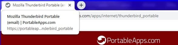

First and foremost, Mozilla has NOT dropped Thunderbird at all. Thunderbird — Make Email Easier. — Thunderbird Though, to be technical, Mozilla is a subsidy on the whole Thunderbird client.
Now please try to understand something. The link I gave you to portable Apps is Thunderbird (the latest). It's just a Thunderbird that runs WITHOUT installation. You can place it anywhere on your computer, on a USB stick, on optical media, SD card, you name it. It's portable. No, the portable Apps website IS NOT affiliated with Mozilla. All they do is take the main installer and make it portable. If you browse the portable Apps website there are lots of niffy applications that all (or at least most I believe) can run without installation. Meaning you can run them from a USB drive or what ever with no dependency on the computer. Keep in mind there are security considerations if you run a portable App on someone else's computer. You can do it, but depending on what it is, like a browser or email client like Thunderbird, I'd shy away from that.
Now I'm saying all this because I'm confused at what you said here:
I'm thinking you might be a little confused as to the title that's displayed for the link that says, "Mozilla Thunderbird Portable (email) | portableapps.com
If that's the case I'll explain this as best I can. The link is to portableapps.com. What this website forum (sevenforums running vBulletin) does is pulls the webpage title from the link and displays that title. So what you're seeing is a web grab from here:
To be more technical, it's a meta property withen the head section of the HTML document at the portableapps.com website as shown here:
<meta property="og:type" content="article" /><meta property="og:title" content="Mozilla Thunderbird Portable (email) | PortableApps.com" />
I don't like forum software that takes links and parses them to show names like that for security reasons. I have a forum much like this one and it doesn't do that, and I'll NEVER add that ability.
So that's where I'm thinking you thought portableapps was Mozzila the horse's mouth so to speak. No, it's for portable Thunderbird. It is the legit Thunderbird, just made portable. Like I said, you can literally have any number of portable Thunderbird's running for different accounts if you wish. There are no installation dependencies tied to the registry and what have you.
I wanted you to run portable Thunderbird (which would by default be the latest) and add your account Info. in there to rule out any shenanigans with your current installed version of Thunderbird you already have installed. Make sense?
The goal here is if you can connect to your email server in portable Thunderbird, then we can assume it's your old version of Thunderbird. Though, you should update your current installed version of Thunderbird for security reasons.
Now, I checked some nerdy things out with your email provider. All looks good on their end. To be specific, their email ports are open and the MX (Mail Exchanger) record is published. They are also not on an email blacklist.
Please try the instructions given here: MPC Email Settings & Help | Milwaukee PC
Instead of no encryption, use encryption.
Secured (SSL) Configuration
 Incoming Mail Server:     mail.milwaukeepc.com
 Outgoing Mail Server:     mail.milwaukeepc.com
 Server Requires Authentication:     Yes
Incoming Port (POP / SSL):     995
Incoming Port (IMAP / SSL):     993
Outgoing Port (SMTP / SSL):     465
Toward the middle of the page they tell you how to configure Thunderbird, but without the use of encryption. I have no idea why they'd have you do that. Ports 993 and 465 should work. And the above steps will, or at least should work in Thunderbird.

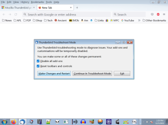

This may be progress.
Admittedly I do not did not know how to use troubleshooting mode for Thunderbird. But since I'm on a scratch disk
I tried some things with that.
So far I am still testing. But in Troubleshoot mode there is an option to turn off preferences and another box.
I can screen shot that for any persons needing to see the operation.
When those two boxes are unchecked, I reloaded T-bird. successfully. I sent a message to me, shut down, then
restart and the message downloaded from server at startup. This without having to hit the Get Mail tab which is the point of my original request. What I don't know is what the two check boxes control. I had no special preferences
or such that this Thunderbird Troubleshoot "safe" mode changes.
I'll run this HD for a few days then if without incident, just save what I have to a fresh backup. More news as it develops.
Nowhere had I seen this option to run Troubleshoot for this particular problem. But we'll see if it's stable or if "everything I know is wrong" again.
- - - Updated - - -
I'm ready to mark this solved. If anyone mentioned Troubleshooting in Thunderbird earlier I missed it.
But I'll still read through the longer entries again from the top.
To summarize, this problem was solved by going to Thunderbird > Help tab > Troubleshoot > select the two check boxes
and restart the program. This seems to set those options to off and saved. I could not see any changes in the preferences at all since I didn't have anything special customized.
thanks to all who responded.

problem HD, setup, profiles and whatever else gets installed. And today I noticed that some setting is being saved where
the previous open tabs come back at a fresh restart of Thunderbird. I can't explain it any better.
I went into the More Troubleshooting Information option. Here I was able to finally see Profiles which has just
been a problem for me to understand.
I don't know if one or the other should be deleted for the program to function correctly and I made a picture of that.

This is too much. I got into some repetition loop where the only thing that happens is a setup screen
reappears over and over. Warnings appear about insecure account and sends me back to this setup stuff and
asks to retest. If I commit to a save after it has detected the account, it just repeats the blank setup screen.

I tried the instruction at MPC. Filling in the boxes did not go well again. What I was looking at as incoming and outgoing ports in your notes above was for secure connections. The MPC pages just
give the usual Port 110 incoming and SMTP 26 outgoing. I had a problem redoing entries that
looked to have different descriptions as secure insecure, authentications etc. and this produced
an inability to login even though I was following what description you gave. The further along this goes the worse it gets. Other civilains are not going through this. Whatever it is is broken on this
HD.

Another dead end. I did a fresh download I am given the same screens to fill in as usual and the error this time was of duplicate account. Perhaps it is that sqlbit, but the problem existed before that. Recall that I ran troublshoot on the
other HD and the problem went away. It seems insoluable and I am spinning my wheels here for nothing.
Last thing today is I'll move the Mozilla folder again so I at least have something.

As I recall from the hand copied Notes I made from your link to MilwPC, Encrypted Password
was not shown. This may have been another error in redoing all the notes I had. I mentioned earlier
a couple of terms looked different across all this.
Server Settings
Authentication method Encrypted Password
Connection Security None
SMPTP
Authentication Method Encrypted Password
I will connect this HD to it's normal primary use and see if the Get Messages at startup works again.....
