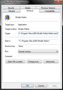

1.Search for your browser shortcut (Desktop, Taskbar or Start Menu Shortcut), then right click on it and select Properties.
2. In the Shortcut tab, in the Target field, remove the wsearch.com argument. Basically, there should be only the path to browser executable file. Nothing more.

Should look like this

checked all 3 browsers properties. all have the correct path in the target fiels and no sign on wsearch in it. I was able to stop wsearch in services but its now running again after a restart. :(
ie tho, in the start in field it has %HOMEDRIVE%%HOMEPATH%
the other two seem to have correct path in the start in field.
sorry for this man, i know its gettin late, this can wait ;)

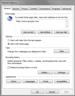

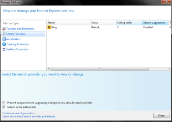

Make sure these are set correctly

ie did prompt to say that something had changed my homepage and that it was set back to bing.
they all look fine now from there, there is no sign of it, its only in services, in the task manager. :/
