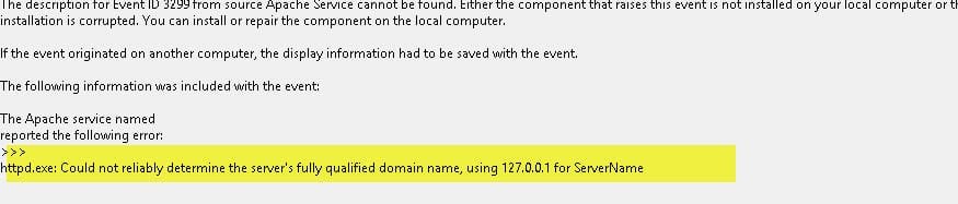

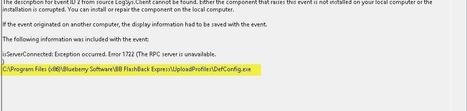

Please provide us with your Event Viewer administrative logs by following these steps:
Click Start Menu
Type eventvwr into Search programs and files (do not hit enter)
Right click eventvwr.exe and click Run as administrator
Expand Custom Views
Click Administrative Events
Right click Administrative Events
Save all Events in Custom View As...
Save them in a folder where you will remember which folder and save as Errors.evtx
Go to where you saved Errors.evtx
Right click Errors.evtx -> send to -> compressed (zipped) folder
Upload the .zip file here.

I see that you have Bitdefender installed. This is a known cause of lag for some games and general BSODs. Also, there are A LOT of references to the trufos.dll failing to load. I would recommend uninstalling Bitdefender How to uninstall BitDefender
Then install Microsoft Security Essentials to see if the problem persists.
Also, a disc that you are using in your Optical drive is bad. If it's a burned disc, reburn it at a slower speed. If it's an original disc, get a replacement.
Actually, looking at this log, it looks like you may be in need of doing a clean install, it appears as though you have a lot of failing programs. Do you download a lot of torrents? Programs that are modified and uploaded online are notorious for causing system errors. Try uninstalling Bitdefender first to see if your problem persists.
http://www.bitdefender.com/support/How-to-uninstall-BitDefender-333.html
