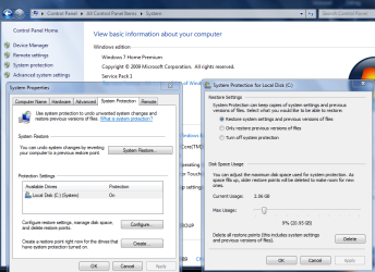

Hi Microbell,
Although you have turned restore(protection) back on, did you >>configure<< it.
see screenshot.
Roy

Hi Microbell,
see screenshot.
Roy
Yes I Did.
It's set at about 5% (12GB) which generally gives me about 5-6 restore points before they cycle out.
