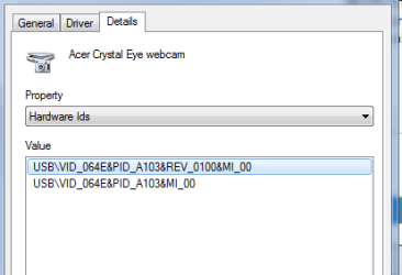

Hi Uralowl,
Open device manager go to the problem device,
Right click >> properties >> details>> scroll down to Hardware IDs.
post the details.
Roy

I tried shutting down the computer completely, instead of simply restarting. After switching it back on, the sound seems to be functioning normally again now, as if nothing ever happened. This is very similar to the last time I was having issues with the sound; it was an on-off issue for about a year, where the problem would randomly occur every few months or so for about a week or less, and then it would disappear again for another set of months.
I've had this computer for about 7 years, only done a few hardware changes to it since (aside from changing the soundcard, I've also had the change the CMOS battery once when the last one died, and installed a new hard drive alongside my current one 2 years ago).
I have to wonder if my computer has some kind of issue of not recognising the sound card on some occasions?
Hi Uralowl,
post the details.
Roy
From what I'm currently seeing under Hardware IDs (now that the sound is currently working):
