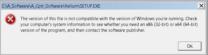

I've been using a 2D drafting packing I first purchased in 1998. Ran well on XP, but I've just moved to 7 and it won't load. Attached is the error popup. Any suggestions on how I could run this? The software has evolved into a modern 3D cad program, and very expensive. My version hasn't been supported for upteen years. I am long retired and have been using this for hobby projects. I really don't want to learn another package as this one met my limited needs.
Thanks for any ideas! (PS software called Vellum Draft)

Is the Windows 7 OS 32 or 64 bit? It appears that the software is 16 bit and if that is the case there is no hope of running it on a 64 bit OS outside of a virtual machine.

LMiller7 -- I have 64 bit Win 7, and given the age of my Vellum it probably is 16 bit. I've read how that is sort of 'fatal'.

fireberd -- OK, compatibility mode isn't as complex as i thought. I changed compatibility to XP sp3 then clicked on the setup file and got the same popup as in my original post. Then I used the Troubleshooting wizard, and it recommended XP sp2 but when I tried to save the configuration it said it was incompatible. So no luck.

fireberd -- I tried compatibility setings for 98, NT, 2000, XP sp2, and XP sp3. Each time I try to run setup I get the error popup I described at the beginning.
milesahead -- I tried Dosbox and it loaded fine. However I was not able to find a way to load my software. I pointed to the cdrom, it saw it along with the directory. But when I tried to run setup it gave me an error, something about it being windows (I forgot to write it down).

It appears that the software is a 16 bit Windows application. DosBox will only run DOS applications, not Windows. There are no compatibility settings that will run a 16 bit application on a 64 bit OS.

Yes it does seem to be an almost fatal situation. I did some reading on dual booting and for an occasional use software it would be a bit cumbersome. So I guess I will begin exploring some of the freeware drawing programs. Until I change, I will use mine on an old XP laptop. It works fine and I can use wifi to send print jobs to my network. Still a glitch or 2, but workable.
