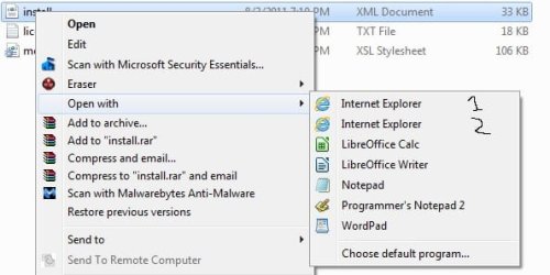

Hi i went to open a .xml extention file and as i have always done i chose to open it with ie so i could read the file in its formated version. I am running Win 7 pro 64
I noticed that i had two ie options on that menu as seen below in the image twoieopt.jpg

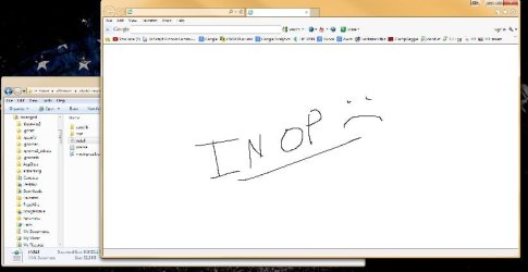

So i selected the first one and what came up was nothing, just a blank ie page but nothing works, not the about option - nothing happens and if i try to manually put in the local file url it just closes. This is shown below in the image trytoopen1.jpg, it acts like a defunked or broken ie version.

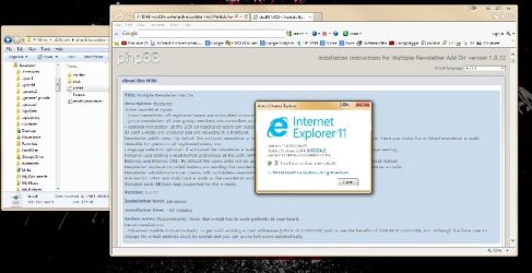

So then i chose the second option and it works fine as seen below in the image numb2works.jpg

But when i go to repeat the process and choose ie again to open the file, it always recreates the defunk version again, and we are back to square one. I cant figure out what number 1 ie option is, is it 32 bit or some kind of broken version and how to get rid of it.

Yes thanks so much, DL and restoring the association worked perfectly, now there is only one option and it loads right up..
Thanks so much..
