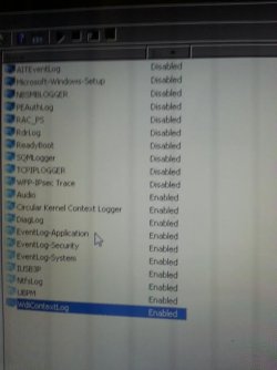

It says with the exception of the following necessary logs, (Application, SEcurity, System, and Security ESsentials), I can disable them from starting.
The only ones I see are EventLog-Application, EventLog-Security, and EventLog-System that are Enabled. There's no Security Essentials listed under Startup Event Trace Session. If I left the 3 alone enabled, and disabled the rest, should I be okay with my system?
Go to start/admin tools and select performance monitor. Expand data collector sets. Click on Startup Event Trace Sessions.
With the exception of the following NECESSARY logs (Application, Security, System, Security Essentials) we can stop them from starting. To do so, right click on each one that has a status of Enabled (except the ones mentioned above) and select Properties. Click the Trace Session tab. Unselect Enabled. Click Ok. Repeat for the others (including readyboot).
After your next boot, you will have a lot less writes going to the SSD that are not needed.

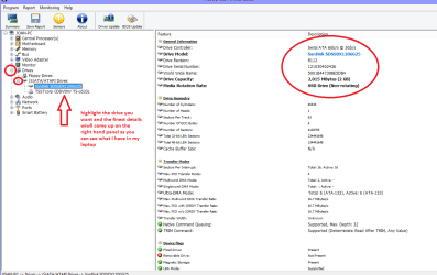

As Derek says mate and if you want to try and optimize the rive you could find out what brand it is and use their software to do just that. You can find that brand with HW Info
HWiNFO, HWiNFO32/64 - Download run it and then close the right hand window and in the left hand window open up the drives and then open out further to see details of the drives (see my pic)
Handy program to keep too for the other gear installed and especially if the machine isa laptop that often list components as graphics etc and don't give the brand name and so make it hard to find drivers for them.
Also see this http://www.sevenforums.com/tutorials/11728-optimize-windows-7-a.html :)

the program you linked me, is it safe to download their program to download drivers?
HWiNFO, HWiNFO32/64

You don't need a driver program, those usually cause more harm than good.
Only use the manufacturer or OEM to find your drivers, you don't always need to update drivers if you're not having problems.
Do you need help finding a missing driver? We have always been able to track them down for people.
You would help yourself and us by filling in your system specs completely, this will help with that,
http://www.sevenforums.com/tutorials/180324-system-info-see-your-system-specs.html
Since everybody knows you don't have a "California" Operating System, that is a good place to start. :)
