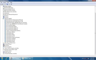

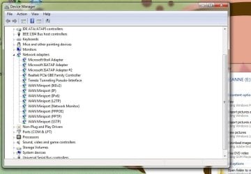

Can you show me this page please, first picture.
Or can you show me a screen shot of your device manager after clicking on "View" then "show hidden devices" .

here you go, the first screen is from my laptop, the second one is from my PC.
both have dns problem,
cheers :D
Ok everything looks normal there, no miniport problem.

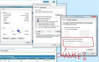

ok, you mean to say, i have to go to my router setting, which is i go to firefox and type 192.168.1.1 and change it there or in the photo shown.
That is your IPv4 settings windows not your routers set up page?
You could try changing the DNS in your IPv4 properties but it's best to go into your routers settings to change the DNS servers by typing in your default gateway of 112.201.0.1 then navigate to the DNS server settings and change to the ones I posted earlier.
It may work either way but I'm trying to avoid any type of DNS conflict by making the changes in your routers settings.

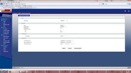

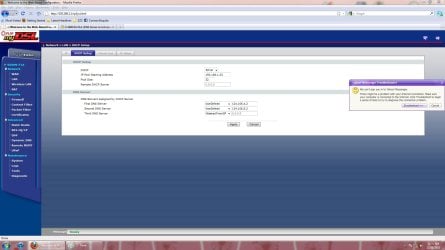

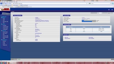

here are the photo from 192.168.1.1
is it the 2nd photo or the 3rd photo to type the dns
Probably best to use the one for DHCP set up, so third picture change both of those DNS servers to the ones I typed in earlier then hit "apply" and check to see if your connection works any better. 208.67.222.222 and 208.67.220.220.
