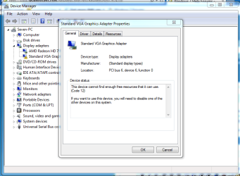

It still has the yellow triangle in it, and I get this when I look at the properties:
My motherboard doesn't have internal graphics and neither does the CPU. The graphics card has dual DVI outputs, and I run one monitor from HDMI (monitor has broken DVI port) and one from DVI. It works fine, and did work well in the past in my previous install.

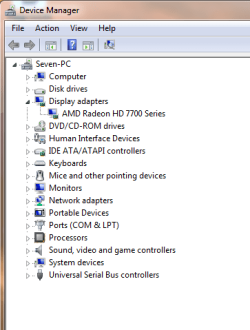

In my previous install, the graphics adapter line in Device Manager showed two Radeon 7700 series entries, but this time only one and the Standard VGA entry. I've tried updating the graphics drivers, as well as the chipset drivers, and no luck. I even tried updating the driver manually, but the only option is the VGA driver. Choosing "Have Disk" will get me to the Radeon driver, but it tells me that it isn't for my version of Windows and won't load. That's weird because it's from the AMD setup package that I used to install the drivers for the video card in the first place.

I can't think of any reason why that Standard VGA device should be there.
Code 12 means there are not enough resources to run the device - "disable other devices using these resources in order to use this device".
Me thinks that Standard adapter has got to go.
You could try a Clean Re-installation of the graphics card.
First, disconnect your second monitor - you could go one step further and go into Display Settings and remove it from there first.
Then do like so:
  • Go to the ATI or nVidia website and download the most current known good driver and save it to an easy to find location.
  • Now go into Windows Explorer and in the C: drive find the nVidia or Program Files > ATI folder (inside will be Drivers > your driver version) and delete it (the whole folder).
  • Go into Start > Control Panel > Remove a Program and uninstall all programs for the video card. For nVidia, do PhysX and the Vision drivers first, then the main driver. The control panel will uninstall with the driver. For ATI, select “ATI Catalyst Install Manager” and click on “Change”, then “Uninstall All Components”. Do not restart the computer at this time.
  • Run DriverSweeper to uninstall all video remnants Guru3D - Driver Sweeper . (This step may not be necessary if you are not replacing a video card)
  • Restart the computer.
  • When it reaches the desktop Windows will find new hardware and will install it's own WDDM1.1 driver. Let it. You will be asked to restart. Do it.
  • Once back on the desktop you can now install the nVidia/ATI driver package for your card.
See if the Standard VGA device goes away after that.

I did everything except the Driver Sweeper. It's not available for download any more, at least at that link.
I unplugged my monitor, deleted the drivers, deleted the Standard VGA, rebooted with the monitor still unplugged...
It installed the VGA driver again, asked me to reboot. I reinstalled the graphics drivers after rebooting, then turned off my computer, reconnected the monitor and powered up again. The second monitor is working, but the VGA driver is still there.
I'm totally stumped.

That is really weird. You got to find out what that device is.
Have you tried checking the Hardware IDs for it?
Deep in the recesses of my ancient brain I recall dealing with this before, but I can't remember what it was. If it comes to me I will post back!

I did check the Hardware IDs, but I'm afraid I don't understand what to do with them, or what they mean.

Here is what you do:
There are only two 4-digit codes you are concerned with. See that first blue highlighted line? Your VEN code is 1407, and your DEV code is 8000. You make note of these.
Then you go here:
PCI Vendor and Device Lists
and enter the codes (one at a time) in the appropriate fields.
We find that the VENdor (manufacturer) is "Lava Computer Manufacturing Inc."
And that the DEVice is (most likely) a "Lava Parallel"
There are many other devices with a DEV code of 8000, but that is the only one by Lava Manufacturing.
So now I got to ask, do you have a parallel port on that machine?
Why, yes I do, and it's a Lava. It's coming out right now. Stupid thing never worked right anyway.
Out it comes and I'll let you know how it goes.

Be sure to uninstall it (probably Standard VGA too) in Device Manager before yanking it.
