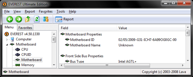

Yes, I do believe the motherboard is the case:
I will search for some drivers and check the BIOS. Will post back with the outcome...
