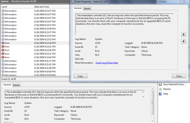

ok im not sure if this is correct. i assumed the error would show a bunch of times considering when i tried to play a game online (warcraft 3) it happened every 30 seconds to a minute. very annoying.

What the troubleshooter is telling you in the screenshot is this may be directly related to a BIOS issue.

Now that was useful. if you look at the info in the snip, it says the source of the error is acpi. acpi.sys is used by the video driver and is taking too long to load hence the freeze. the way to correct this is to get the most current driver for your video card and install it. I will be lurking this thread so let me know how it turns out

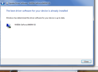

yes i juust updated to it yesterday.... same issue nothing changed
win7
says best driver is installed
win7
vid driver
the message also says it could also be caused by your bios. did you update that as well?

umm ive never taken the laptop apart but that sounds like a good idea. yes there was a new bios released and i just updated to it yesterday. i went into the device management tab and located the graphics card and searched online for drivers. im going to HPs site now to see if anything different is there.

That is NOT the way to update your Nvidia 8400M GO Graphics processor driver!!! Never rely on Windows to update your drivers!!!
EVER!
You have to Manually go & download it from Nvidia under Windows 7 Drivers!!!
Here's the info & link to that... ;)
GeForce Driver Release 186 for NoteBooks WHQL Version: 186.03 Release Date: June 09, 2009 Operating System: Windows 7 (32-bit) Language: U.S English File Size: 112 MB
This is for the 8400M Notebook graphics processor
which is what supposed to be in that Laptop...
